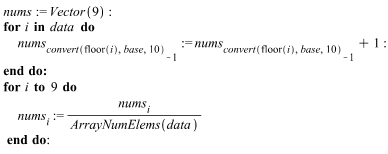

Once you’ve found a suitable data set, using Maple to calculate the frequency of leading digits is simple.  Assuming that the data arrives in an Array called data, this snippet of code returns a Vector nums with the frequency of the leading digits.
