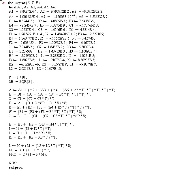

I want for my work to calculate the International Equation of State of Seawater
but when i enter my fonction in mapple: it is like mapple don't recognise the second variable s:
>t:= -> t;
s:= -> s;
> g :=(t, s)-> 999,842594+6,793952*10^(-2)*t-9, 95290*10^(-3)*t^2+1, 1685*10^(-4)*t^3-1, 120083*10^(-6)*t^4+6, 536332*10^(-4)*t^5+8, 24493*10^(-1)*s-4, 899*10^(-3)*t*s+7, 6438*10^(-5)*t^2*s-8, 2467*10^(-7)*t^3*s+5, 3875*10^(-4)*t^4*s-5, 72466*10^(-3)*s^(3/2)+1, 227*10^(-4)*t*s^(3/2)-1, 6546*10^(-6)*t^2*s^(3/2)+4, 8314*10^(-4)*s^2;
to this step all is good but when i want to use this foction i have :
> g;
> g(1, 2);
and the same result if s=1,3,2,4,x
> g(t, x);
there is no x in the expression.
it is like mapple don't recognise the second variable . Have you an idea why it don't recognise it ?
What am I doing wrong?
