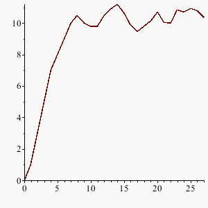

Ok guys this is the problem i have a matrix wich is really the result of a semivariogram so it is like this
plot([[0, 0], [1, 1], [2, 3], [3, 5], [4, 7], [5, 8], [6, 9], [7, 10], [8, 10.5], [9, 10], [10, 9.8], [11, 9.8], [12, 10.5], [13, 10.89], [14, 11.2], [15, 10.6], [16, 9.85], [17, 9.45], [18, 9.77], [19, 10.15], [20, 10.7], [21, 10.04], [22, 10], [23, 10.85], [24, 10.7], [25, 10.94], [26, 10.81], [27, 10.33]])thi is my semivariogram so i have to find the best model and fit it to it, i can't just throw a polynomial it has to be
spherical= h:= C((3/2)*x/a-(1/2)*x^3/a^3)
expotencial=Upsilon := C(1-exp(-x/a))
Lineal= y:= p*x
or y:=p*x^a
so i want the maple to show me the variogram plot and the i select wich one of the models i will apply.
the problem is that i don't know how to apply the models so started something that could maybe lead to the values of C and A for the spherical and the xpotencial becouse the others too are easy.

so in this code i rest the values of the model and the values of the matrix for differents C and a so i pick the min of the Sum to see wich C and a give me the min value but i didn't work quite well first is difficult to get the C and a and sometimes the new curve is just not similir to the semivariogram (Matrix) please help i tried
k := NonlinearFit(C((3/2)*x/a-(1/2)*x^3/a^3), X, Y, x)
and
k:=LeastSquares`(m3, v, curve = C*(1-exp(-x/a)))
but they don't let me because they aint linear on the parameters
please help
