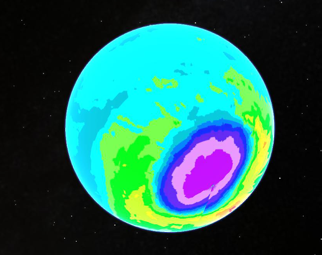

1. What I'm hoping for is an ouline of the globe visible through the contours
2. Instead of the contours being drawn flat on the sphere I'd like the higher numbers to represent a height above the sphere, the colours representing height.
 I know there's a zhue COLOR setting but I wondered if there's an RHUE?

1. Is it possible to make the countour plot transparent so that a globe can be plotted underneath?
2. Is also possible to make the contourplot vary by the value given + the radius of the sphere (in other words to produce hills and valleys where the colour varies by distance from the origin?

The data comes from satellite measurements and so there are gaps in the coverage near the equator, hence the streaks. The break in the meridian is a feature of the data that I need to get back to the curators on.

This is what my data should look like (in a contour plot on a sphere)
But how do I create this in Maple?
