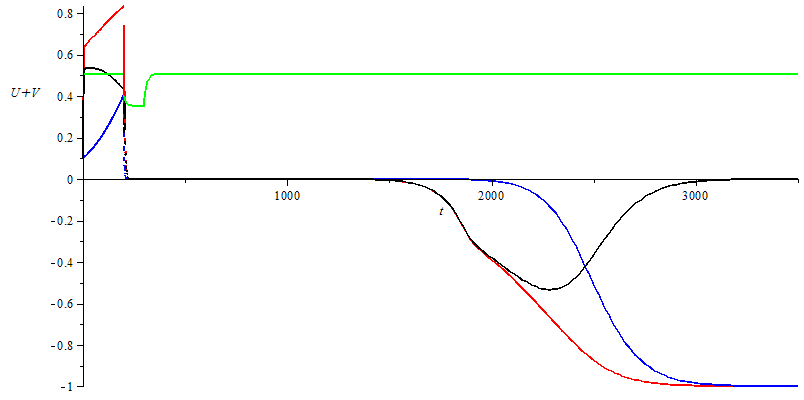

For the simulations I described above, I have used the following:
  • Digits = 10
  • No stepsize specified
  • Default method (rkf45)
  • Default values for abserr, relerr
  • Integrating with respect to t, from 0 up to 3500 (t represents days)
Here are some plots. U is blue, V is black, U+V is red. The green line is a function that has an effect on the ODEs for U and V.
The first plot is without any events specified.  The dashed lines around t = 200 are caused by stopping and starting the simulation using new initial conditions representing near-instantaneous changes in U and V.  I do not think this part of the negative values issue, which generally occurs later on.

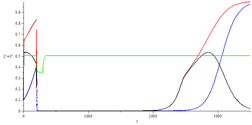

The second plot is with events=[[[U(t),U(t)<0],halt],[[V(t),V(t)<0],halt]]:
If the event specification events = [[U(t) = 0..1, halt], [V(t) = 0..1, halt]] is used, the simulation halts around t = 600.
You can see that after a long period where U and V are near zero, the values can grow once again.  The values of U and V, while small, are important in determining the long-term behaviour.  I would like to find a way to simulate this behaviour while minimizing the effect numerical approximation/error has on the behaviour.  Although it is impossible to see on the graph, there are a few negative values for U in the second plot.
Let me know if any other info would help.
