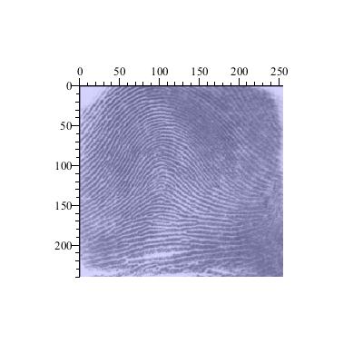

With the command, subpicture,I take the portion of it that interests me.
How I manage to include this sub-image in another image (img)?
Preview(correctedT)
imgs := GetSubImage(correctedT, 100, 125, 20, 120)
Preview(imgs)
ImageTools[SetSubImage](img, imgs, 50, 50)
Error, (in ImageTools:-SetSubImage) image and subimage must have same number of layers and same order
ImageTools:-Mask(img, imgs)
Error, (in ImageTools:-Mask) invalid input: evalhf(zip) expects rtables with equal dimensions
Gracias
@acer
Using the "Preview" is displayed coordinate axes. As you do to put text, for example in the pair [50,50], safe the "Preview". Gracias
Preview
http://www.mapleprimes.com/view.aspx?sf=134660/437880/Preview.jpg
